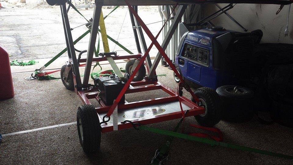

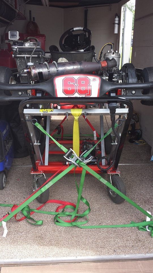

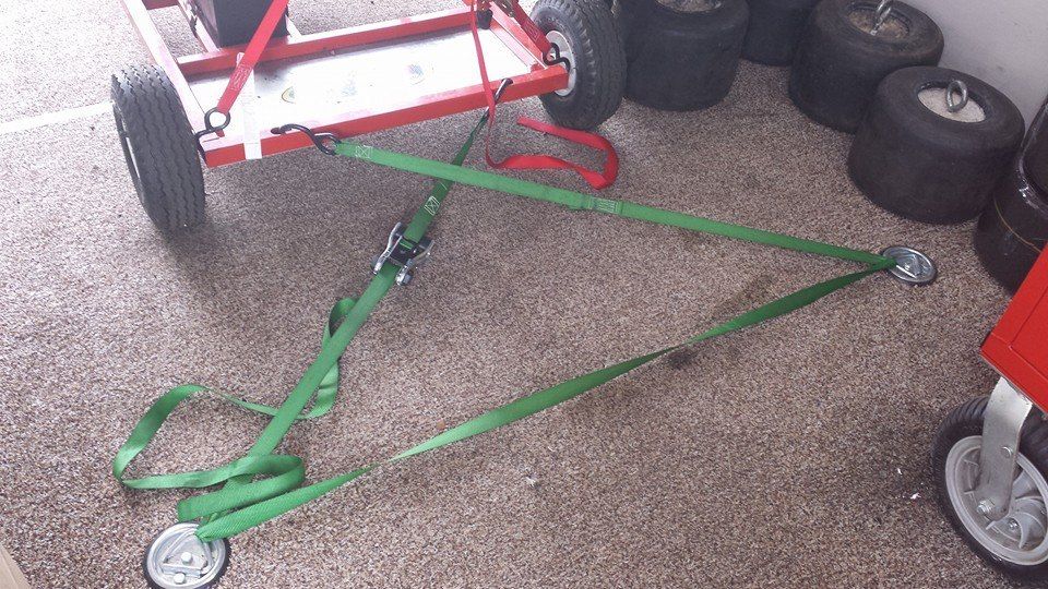

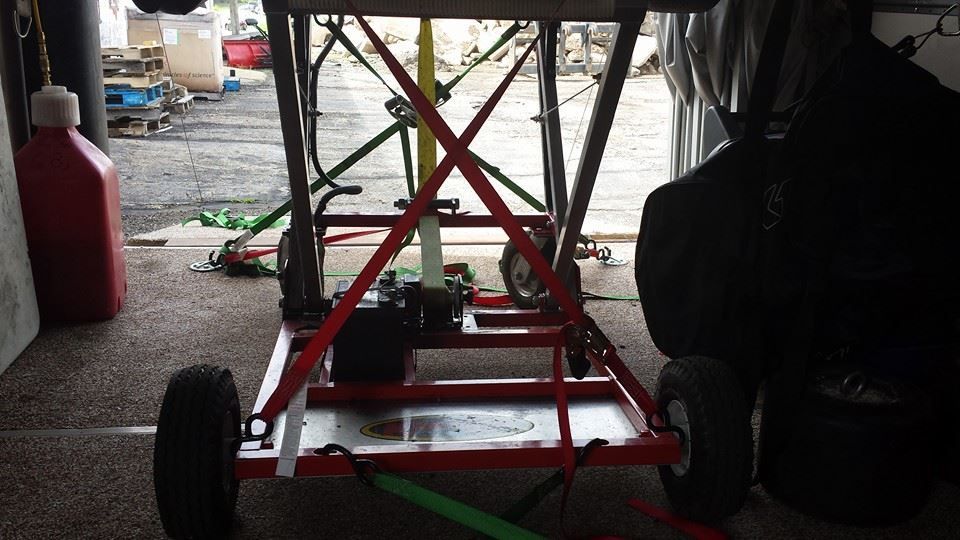

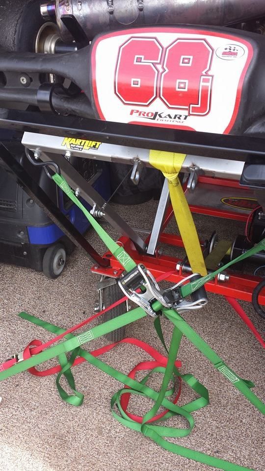

      Richard Kirlin
      saw this on kart lift Facebook site and I don’t see anything wrong with it, hell I’ve done it for a year and no problem yet and I have a shifter kart:)
