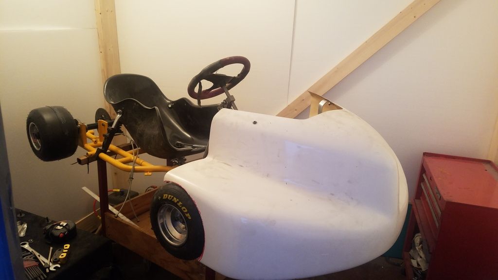

      Thought I’d share my first kart build, I’ve had this chassis for many years but caught the road racing bug as many of you all have as well. Here’s some progress that might inspire someone else. This isn’t my B-stock (obviously) but i will be building one of those later this summer 8)
      Just started working on the body which is oh-so lovely. But i found using a wizzer with just a regular metal cutting wheel works phenomenal for roughing out the shapes. Then you sand it afterwords to make it smooth. Im widening the nose by cutting and rivetting the bottom of the nose cone to spread it apart about an inch so it covers the wheels a little better, But it’s getting there

      yes, floor pan is up next. Thankfully next to my work is a sheet metal shop and they are going to break a piece of .062″ aluminum the size i need so I can get that underway. That’s next on the list
