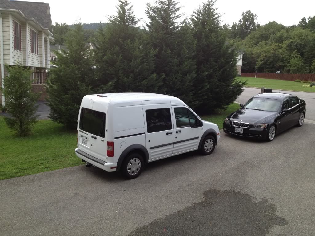

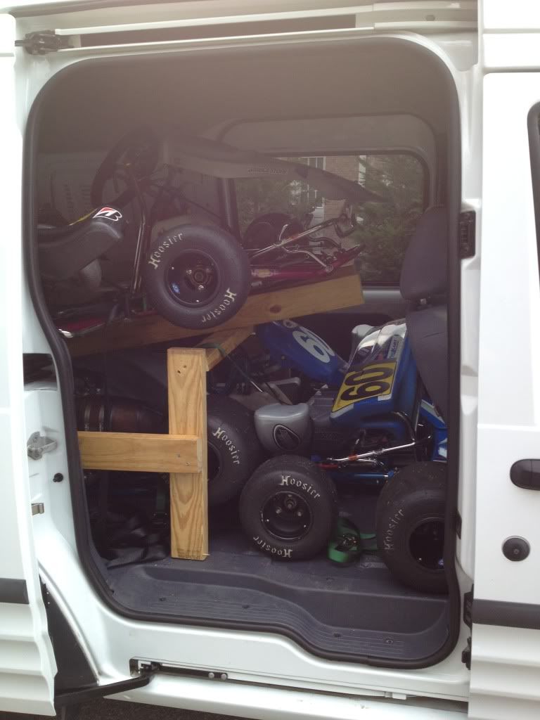

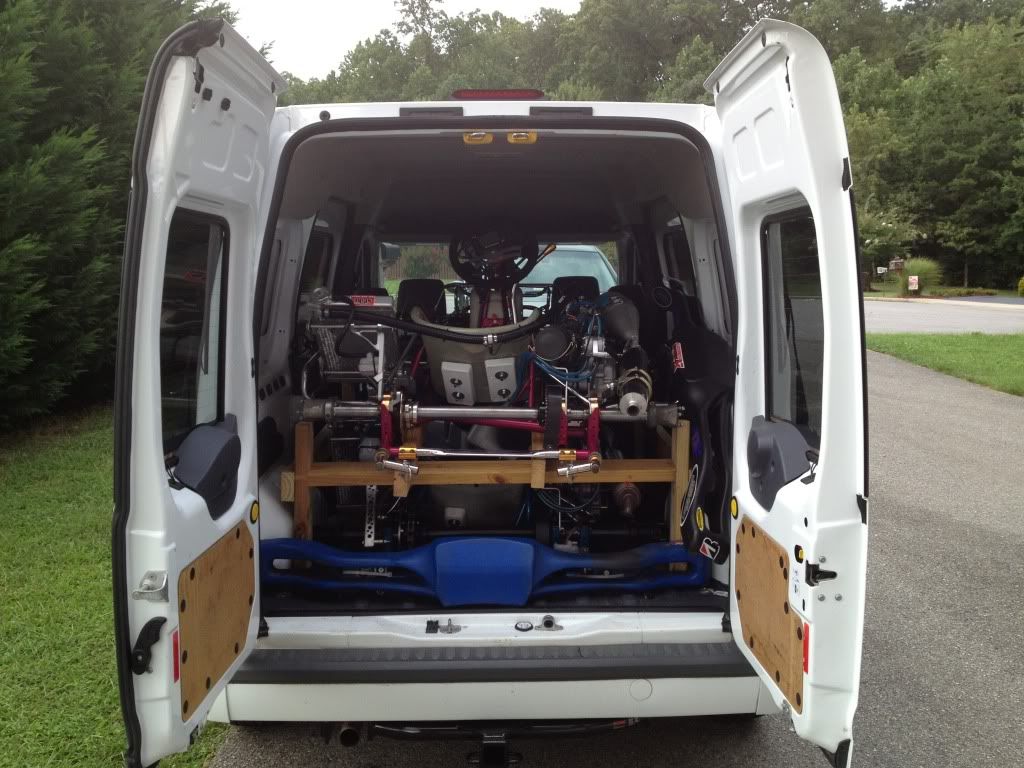

      It’s a Ford Transit Connect.  2 complete karts and all my gear inside while getting 29.4MPG coming home.  I was getting 11 MPG pulling my trailer so this should save me quite a bit getting to the track.

      Nice! Cool solution.

      Very cool! Looks like a pain to load/unload though?

      Excellent choice especially now that these are starting to slowly get cheaper on the used market.

      It’s actually quite easy to load using my electric kart stand (still the best karting money I have spent).  With the van empty, you push the kart with stand up to the back doors and lower it using the winch right onto the floor of the van (you just pull the stand backwards as it comes down.  Then you put in the wood rack (it just sits right over top of the bottom kart with its legs on the floor).  Put the other kart on the electric stand and push it right up to the bottom of the ramp/rack (it’s inclined so that the back end is the same height as the electric stand).  Push the kart of the stand and slide it up the ramp.  I’ve loaded both karts 2x now by myself with no assistance and didn’t even break a sweat!  It easy to strap it down because the van has sliding doors on both sides so you have easy access to everything.  The only things that have to be removed are the side pods and the rear tires.  I need to make a rack for the toolbox and I have one of those trailer hitch cargo carriers for the electric stand.  I can’t park a trailer here at my house and this keeps the karts out of the garage when I am home.  Easy to drive/park/maneuver, great gas mileage.  It’s almost ideal as a minimalist kart enthusiast!  I wish it was two inches wider at the door opening and between the wheel wells.  The extra width would allow the rear tires and sidepods to stay on (not a big deal though).  The rear tires actually fit inside the walls but not through the door opening.  Anyway….makes it easier to get to the track and cleans up some issue here at home (karts taking up wife’s parking place ;)  Amazing gas mileage for its size (better than my BMW sedan….WTF????)  Well….it only has 136 hp compared to the bimmer’s 300 so I guess there’s a tradeoff in there somewhere.

      I’ve been wondering if the Transit cargo area was wide enough for a kart! I now may have another thing to add to the lottery list.

      That sounds like an interesting setup but I doubt it approaches 29MPG.  Fuel costs for getting to the track was the major reason I wanted a van.  This thing is built on the Focus platform.  They basically took the front half of a Focus and welded it to box.  You COULD sleep in it too but you’d have to remove the karts and I would have to have A/C in there at night!  Anyway the setup you mentioned sounds cool.  I’d like to see some pictures of it.
