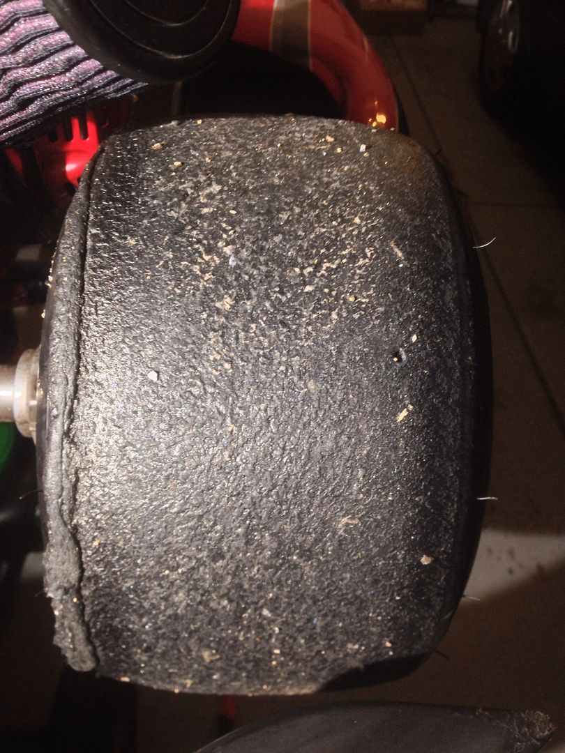

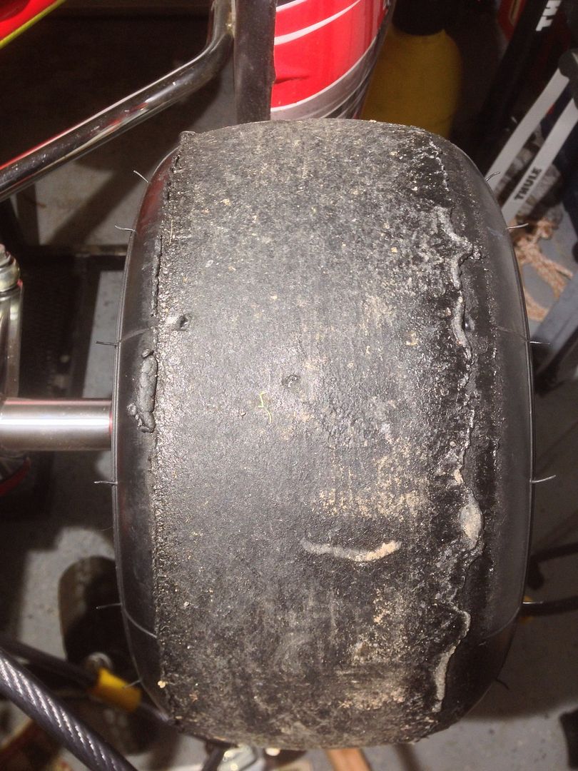

      TJ and Gary- a buddy is letting me try out a 40mm axle this weekend. I hope these pictures upload okay, but I was trying to show the tire wear.
      The rear is the right rear on a counter-clockwise sprint track.
      The front is the left front on the same track. the right front is wearing evenly across the tire. Someone at the track suggested that the uneven front tire wear might be indicative of a bent spindle or frame?

      Front tire looks fine to me. Using the whole front tire is not something I ever aim for. The only karts that appear to get even tire wear on the front are karts that run a lot of caster. The inside tire will actually wear some on entry and with all the caster it gains a ton of positive camber. The rear tires look to be wearing the inside edge hard because the axle is deflecting too much and resulting in camber gain during cornering.
      High tire pressure will also focus tire wear on the inner half of each tire.

      As usual, I agree with Gary’s points. I usually see the same contact patch you’ve shown here, where it extends to about half the outer wear indicator and I’m usually at max caster. You look like you’re actually picking a bit of rubber up on the outer shoulder.
      It looks like you’re too soft on axle. As Gary said, it’s deflecting too much and wearing the inner shoulder. But it also looks like it’s a little blistered, possibly from the rear being over-stuck. Kart is a flat, wet noodle.
      What’s your caster like? As Gary noted, the fronts will wear more evenly with more caster. If you’re picking rubber up on the outer shoulder and the rears look stuck, it might stand to reason that some caster will clean up the fronts and get the rear freer.

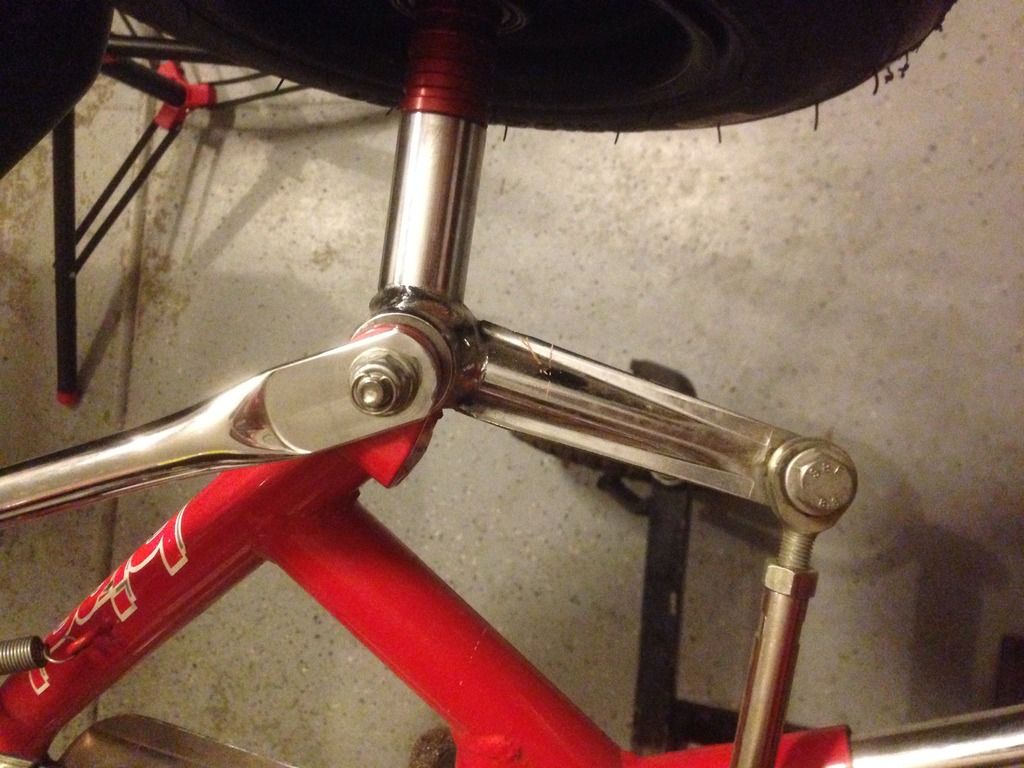

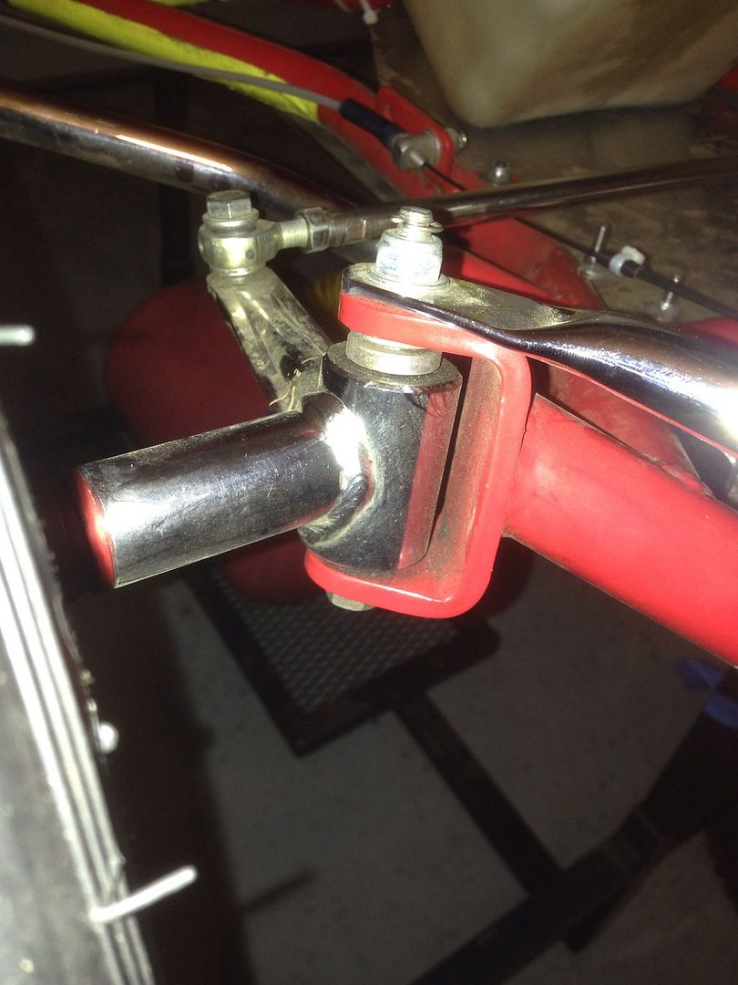

      Can I adjust caster and camber with this design? I haven’t taken it apart but it looks like I can only adjust ride height as the bumper mounts to the king pin bolt.
      this is
    • #44484
      Gary Lawson
      Doesn’t look like you can as is unless it has an eccentric pill on the bottom. Odds are you can drill out yoke on the bottom and put a pill on though. I would also lower that front ride height. Looks like it’s full high.
