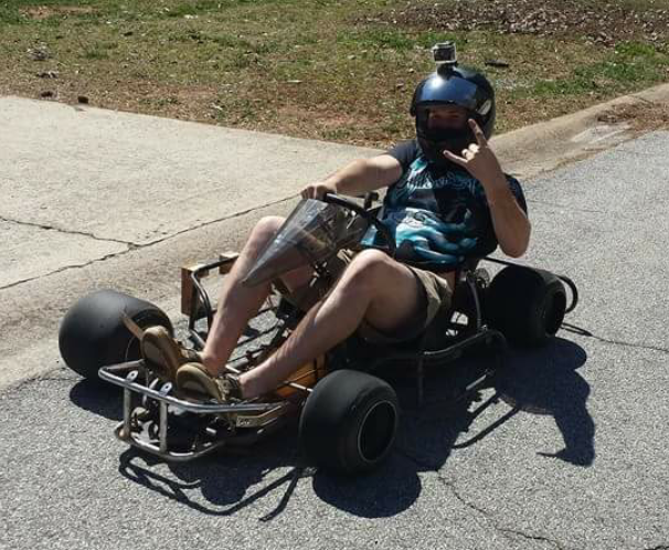

      Cisco Espinoza
      Day 1
      Day 1
      </dt></dl></div>

    • #45154
      Cisco Espinoza
      Can I make this a straight kart?
    • #45155
      Keymaster
      This kart is designed for oval karting. I don’t have experience with it, but my guess is that no, you can not make this a non-oval kart.
      David Cole - EKN Managing Editor
    • #45156
      Rick Brown
      Yes you can, well kind of. Just put the same wheels and tires on both sides. The center everything up from the center of the chassis axle, hubs, spacers etc. It will never go right as good as regular kart but it will work. I ran wka events at N.H.M.S. and Charolette in my asphalt oval kart and did decent.
    • #45157
      Cisco Espinoza
      Thanks Rick. What are some chassis names I can shop for that are for straight karts? Or what exactly am I looking for to buy a non oval racing kart?
    • #45161

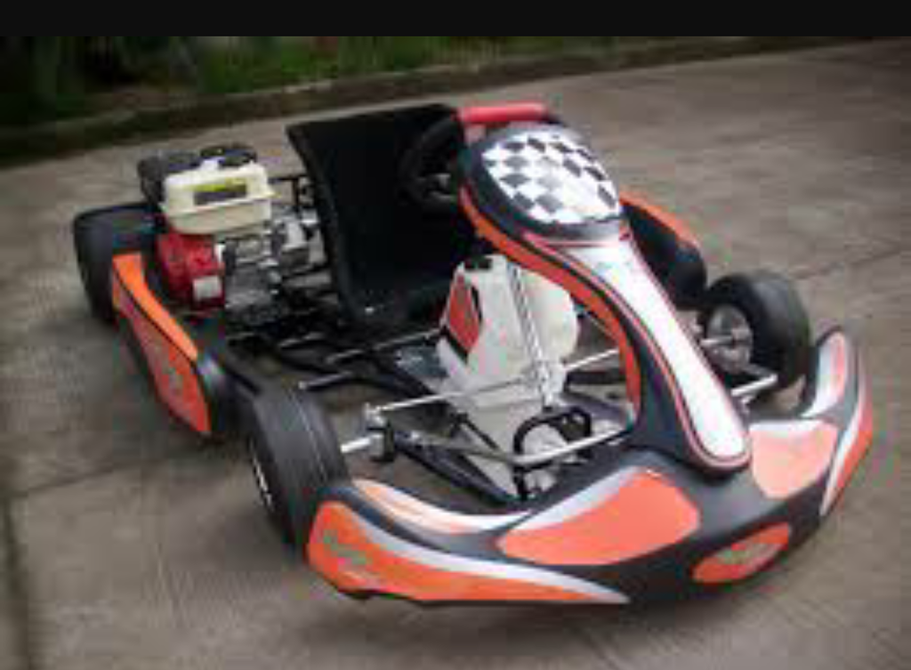

      Cisco Espinoza
      This is the kind of kart I would like to set up. Can you guys tell me what type of frame is used for this look?
    • #45327
      Rick Brown
      There are a ton! CRG, Tony Kart, Top Kart, Intrepid to name a few.
    • #45330
      Keymaster
      The basic concept is correct, however the engine is not something you race. The Atlanta Motorsports Park karting program has sales of karts. Please go there to talk directly with someone to get you going on the right direction. Karting is not something you can just pick up on the internet. You need to be hands on, and then use the internet for tips and suggestions.
