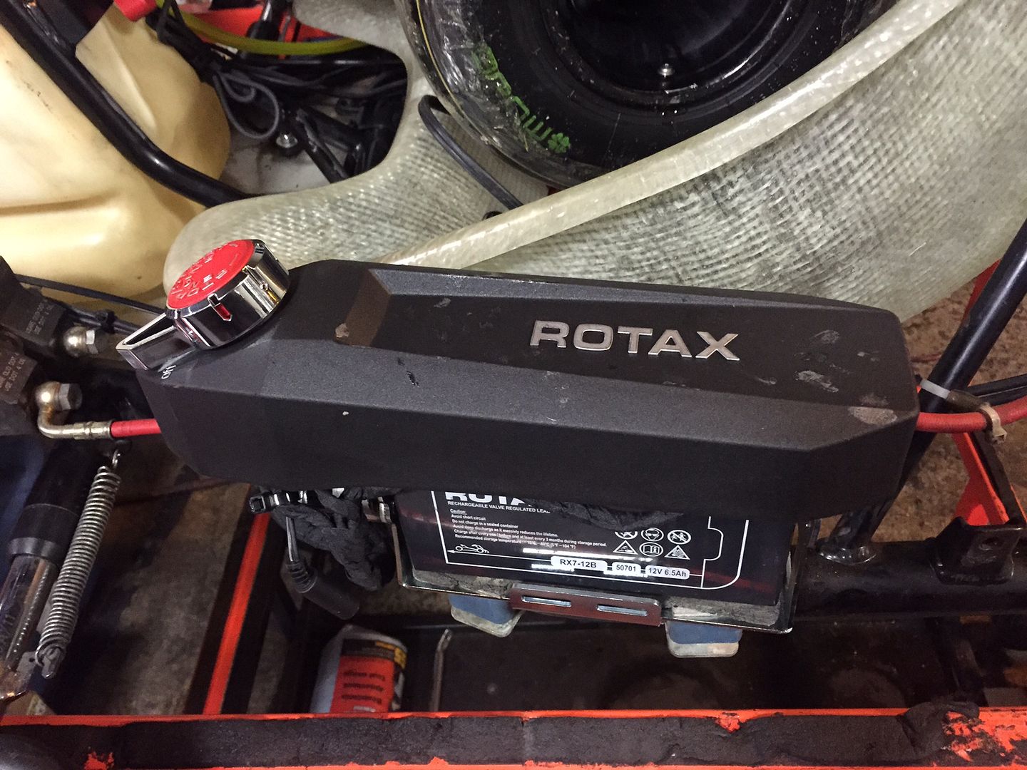

A few random discussion points now that my evo kit is almost installed.
The header opening on the Evo is 4mm smaller than the Prevo and doesn’t come with a gasket. If mixing parts is ok for a while why wouldn’t I run the bigger header?
The wiring harness for a micro is the same as the dd2 so you still end up with a substantial ball of spare wire and even a few extra connectors.
The mount and the instructions are pure shit, anyone with pics of how theirs went together please post!

March 12, 2015 at 3:31 pm #43938Mark TraylorParticipant
Yes Mark, the header is smaller and the muffler tube and outlet are larger. To address the complexity comment I made above you can run all Prevo or all Evo (upgrade) but no mixing of the two. You can not run the old header and new carb, or old ignition with new carb, or new ignition and old carb etc. that sort of mix and match would create a nightmare matrix of complexity that would further the gap between the haves and have nots to the extreme.
There are unconfirmed rumors regarding the future of certain cylinders but it is all rumor and guessing that I do not care to broadcast publicly.

March 12, 2015 at 10:56 pm #43951Mark ParkerParticipant
I set the stop up on the pedal. Did I miss anything? We never ran it much in the old setup so I don’t really know what changed but did the old carb have the stop built in or ?
March 13, 2015 at 7:46 am #43958Mark TraylorParticipant
Mark Parks,
The Prevo micro carb requirs a stop that is inserted into the carb cap. The split tube that has the cadmium plating on it. It restricts the micro to about half throttle. The new XS carb on the micro does not use that stop inside the carburetor, you can run full throttle on the new carb.
