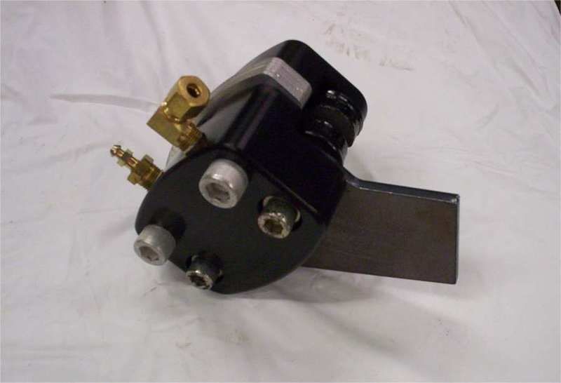

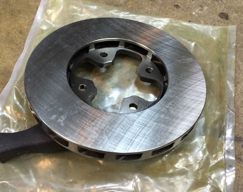

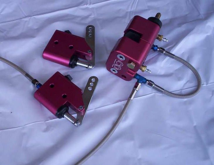

I just bought a nice 7-1/8″ vented rotor from Brian (made by Terry Ives) that bolts to standard MCP 4-bolt brake hub for 1-1/4″ axles.  I’m using an MCP billet rear caliper that has 1-1/2″ pistons (don’t think they make this one any more).   On the front I’m using Enginetics EC-750 single piston caliper.  This is the large caliper that has a 1-3/8″ piston and uses the “scalloped” Enginetics pads which are still available.  I just looked and Russell Karting has a set “in stock”.  That’s were I got mine back in 2008.

EC-750 Front Caliper

Rear Terry Ives Rotor
Masters and Rear Caliper
