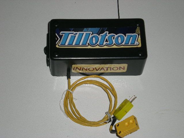

Below is a photo of the small engine transmitter feedback unit. reading back to a laptop.
 1.5  mile range

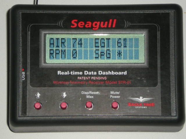

or to a small portable hand held read out unit like below :
