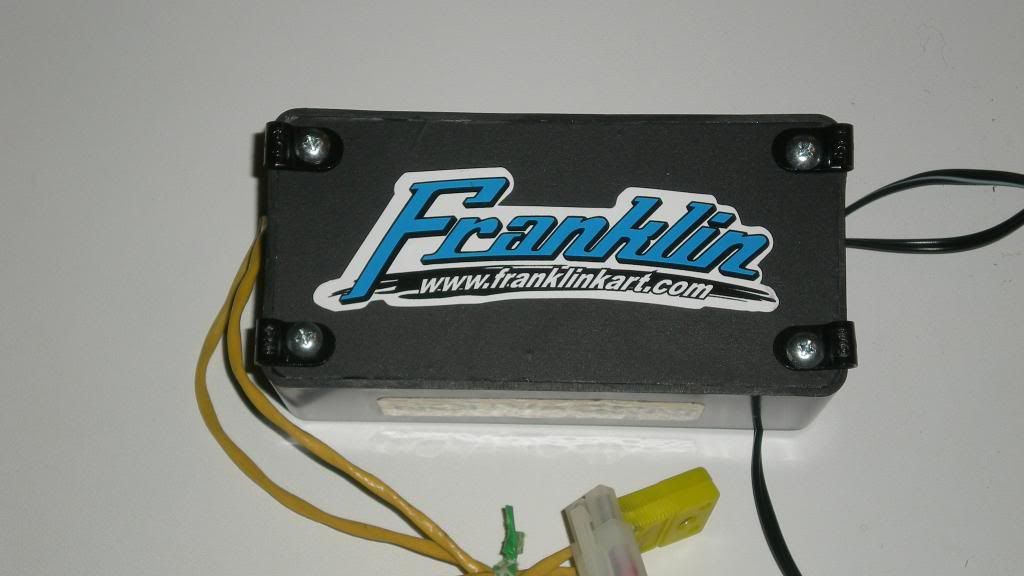

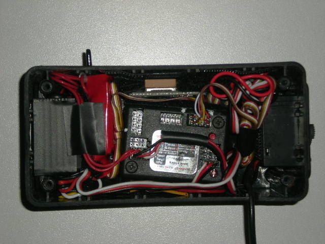

I don’t know if anybody is still reading these posts….But here below is the final piece of the puzzle :
A lot electronic components packed into this small on board Telemetry box below :
1) Over voltage DC to DC converter/protection module.
2) Six volt high capacity Ni Cad rechargeable battery pack.
3) Recorder logger module.
4) Ambient air temperature module.
5) coolant temperature module.
6) Exhaust Gas temperature module.
7) Magnetic induction RPM pick up module.
8) Full function GPS module.
9) High output transmitter for the telemetry system.
10) Side mounted on/off switch with an external charging port.
