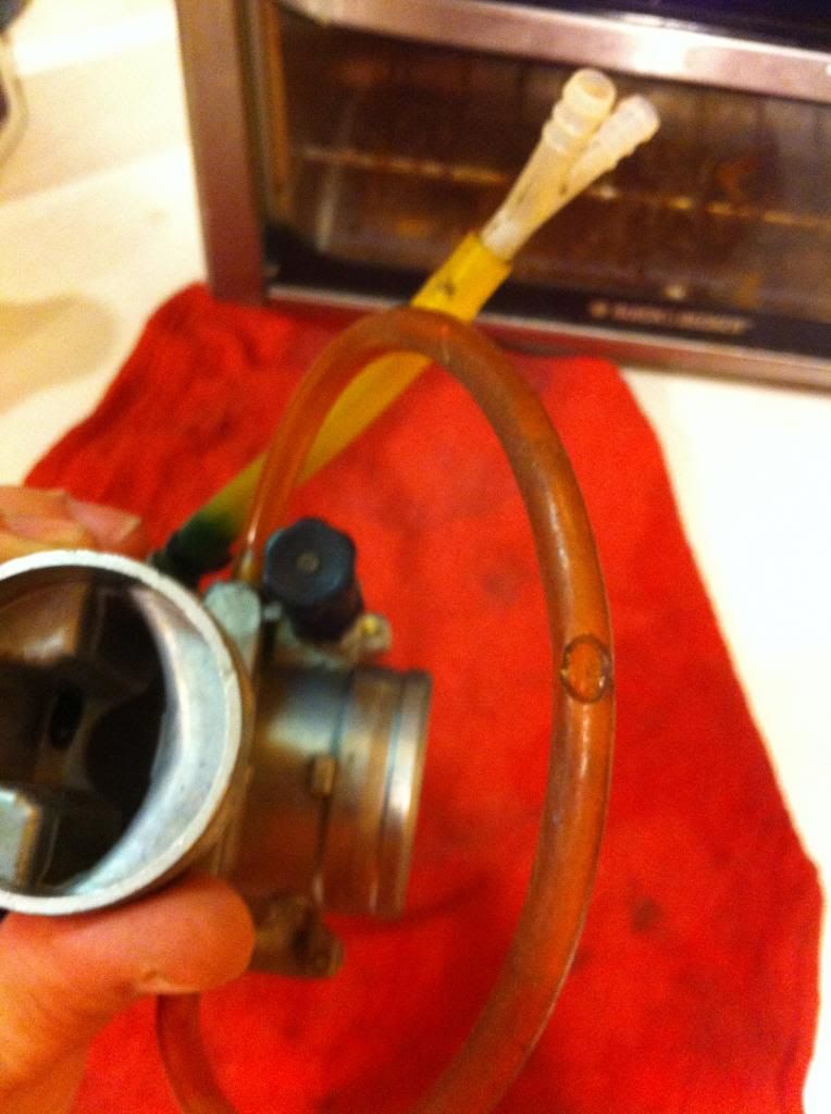

Well I got the new fuel pump on and the old one definitely had issues. I can see fuel flow much better now. It still won't fire though. The carb is the problem now I am pretty sure. I have taken it off and started cleaning it. I will be disassembling it and doing a full cleanup.
Right after I took it off the kart I was tuning it over to look at everything and some pretty putrid looking stuff dumped out of the tube that runs from one side of the carb to the other. There is a hole in that tube. I am guessing there is not supposed to be that hole even though it almost looks like it was cut in on purpose. I hadn't noticed the hole before, oh well. I am attaching a picture of the hole so you can see what I am talking about.
Larry MacLeod
Joined: 28 Sep 2005
Posts: 299
Location: United States, Michigan, Ypsilanti
PostPosted: Sun Dec 30, 2012 2:53 pm    Post subject: Reply with quote
That hole needs to be there. Those are the vents to the bowl. Running a hose across with a slit in it is an easy way to keep dirt out but keep the vents open.

Joe Ricard
Joined: 23 Jun 2009
Posts: 882
Location: United States, Mississippi,
PostPosted: Sun Dec 30, 2012 3:14 pm    Post subject: Reply with quote
Putred fuel is never a good thing.
Drop the bowl and give every hole, port and jet a good blast of carb cleaner.
When you get things back together and are ready to put fuel back in it.
PLEASE just blow in the over flow can and it should fill the lines, pump and carb bowl easy peasy. If it does that you will fire up right away.
Watch that slit hose if fuel comes out of it when engine starts to run then you got a problem with the floats or inlet valve. Yep supposed to be there.

Russ Clark
Joined: 17 Dec 2012
Posts: 37
PostPosted: Sun Dec 30, 2012 3:32 pm    Post subject: Reply with quote
Thanks guys makes sense. I just wasn't thinking to put 2 and 2 together to realize it was a vent. But it did seem that that hole was a little to pretty to be damage. Rolling Eyes

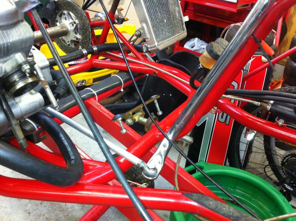

PostPosted: Sun Jan 06, 2013 6:53 pm    Post subject: Reply with quote
I was able to spend a little time cleaning up the kart some. I thought I would post an update to show how it is coming out. I used Simple Green on the stand but it seems to have hazed the paint. So I decided to used WD-40 on the frame instead. I saw that suggested in another post on here. It worked pretty well but I think I need to make another pass or wash it with soap and water. It looks much better but looks like it could be better. I also used WD-40 to clean up the motor. All in all it worked pretty well.

Robbie Nelson
Joined: 26 May 2008
Posts: 133
PostPosted: Mon Jan 07, 2013 6:35 am    Post subject: Reply with quote
The remote reservoirs for the brake master cylinders is neat. I've never seen that before.
Vernon Head
Joined: 21 Jul 2001
Posts: 456
PostPosted: Tue Jan 08, 2013 6:25 pm    Post subject: Reply with quote
I'm pretty sure BRM and Maranello have them.
