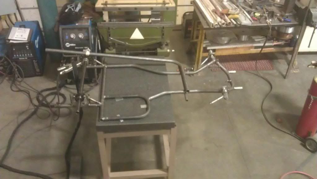

PostPosted: Wed Apr 03, 2013 9:19 pm    Post subject: Laydown Animal project Reply with quote
MG]]
Roger Nelson
Joined: 20 Mar 2013
Posts: 43
PostPosted: Wed Apr 03, 2013 9:22 pm    Post subject: Reply with quote
Only one picture showed up...........I'll get better at it
