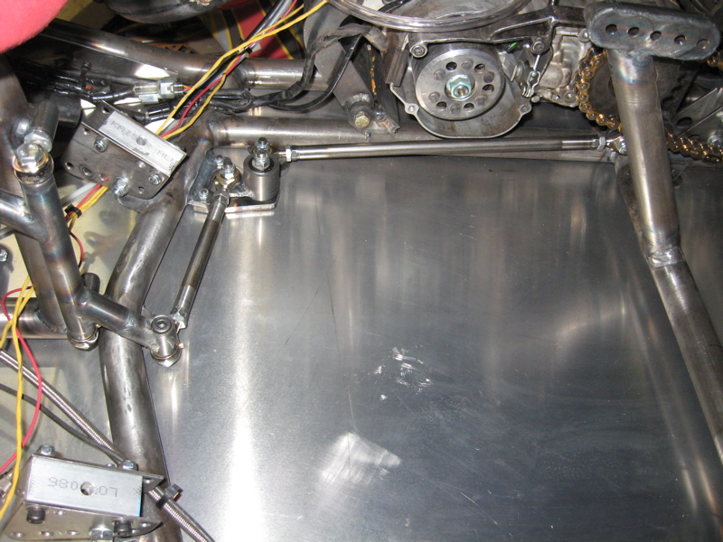

working on fabbing up (I use the term "fabbing" loosly) a shift linkage for the moto motor (CR 125) I just put in my kart, anyone have any creative solutions?
There's the obvious solution, which is throwing a bend in a tie-rod, but has anyone else come up with a better idea? Pictures of said solutions would be great!

Seems kind of silly to do anything other than just put a bend in a long shift rod. Seems to work just fine.

No need too, just keep it simple. Put 2 bends in it and if you have to shorten it make sure to cut the right hand thread side in case you nee to rethread it.
If you aren't racing and don't have to pass tech then last month the was a whole bunch of bickering about an air shift do hicky that ultimately fails...

As for the manual shift arm? Definitely put the necessary bend/s in the arm and run the J-arm in the UP position! Some run it down but the shift pattern is backwards!

What about a cable shifter? I did some research but ultimately bent a rod and it works just fine. I'd love a paddle shifter but as mentioned above, not lega.

KISS - use a shift rod which is the easiest and best solution.

DD2's use a 2 cable system on a paddle. It can also be done with a push/pull single cable. Typically a marine control cable is used. It's called a morse 33C.
The DD2 is probably the simplest aproach. The paddle shift assembly is around $200 and it mounts on the steering shaft under the wheel. You'd just have to fab cable mounts on the engine side.
