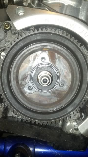

I have one of the newer all solid rotax clutches that a shoe broke on. I think the newest has lightening holes in it. At any rate how do you get the nut off so I can put the puller on it. The clutch is really close to the nut and its recessed in the clutch so a socket wont go on the nut.

Disregard, with the three screws removed and a slight tap with a brass punch it came off. I thought it was more like the Leopard. The newer rot ax clutch removal only requires you remove the three screws holding it on. If I had to remove the starter gear it would have been similar to a Leopard.
Before
After
