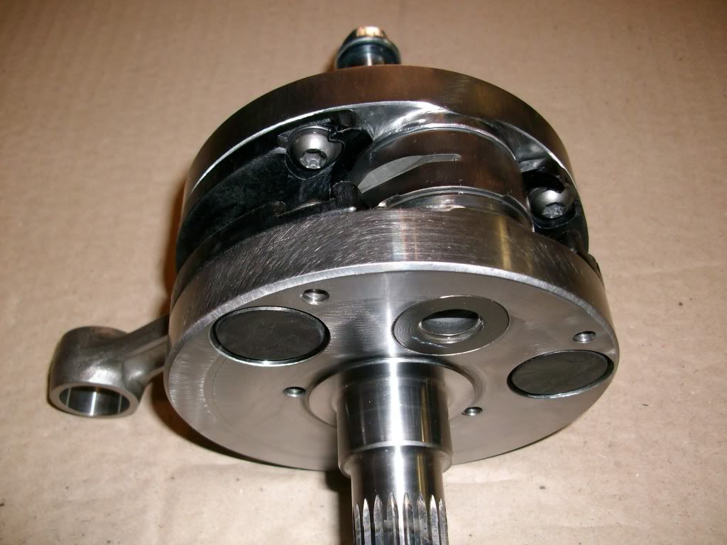

PostPosted: Fri Apr 27, 2012 10:25 pm    Post subject: Reply with quote
This crank will be going into a cylinder reed valve motor after the mods to crank for clearance issues and changing of bf.[/img]
[img][/img]

PostPosted: Sun Apr 29, 2012 4:14 pm    Post subject: Reply with quote
Hi Jeff
Don't forget that if you skim the periphary, that the rod big-end eye will still protrude and describe the same outer profile as it rotates.
You may have to machine some off the outer of the rod big-end eye or the case, I have found the rod eye taps in one or 2 places, but not everytime. you may also want to do this to increase clearance anyway. The O/E rod is plenty strong enough. Don't know about some of the Taiwanese offering like Mitaka or Hot Rods.
Install the crank in the side cases one at a time and fit the cylinder and piston, so you can see what's going on.
Rotate and check for fouling or very close proximity.
Apologies if this advice is basic to you, but it may help others.

Jeff Pickel
Joined: 14 Mar 2009
Posts: 84
PostPosted: Mon May 14, 2012 1:14 am    Post subject: Reply with quote
here is what it looks like under the stuffers.
here is the crank installed in the cylinder reed case.
here is the crank after the machine work and different balance factor

Jeff Pickel
Joined: 14 Mar 2009
Posts: 84
PostPosted: Sat Feb 09, 2013 9:22 am    Post subject: Reply with quote
22 races later at 11,000 rpm no vib or issues.

Ian Harrison
Joined: 23 Nov 2006
Posts: 1671
Location: United Kingdom (Great Britain), Manchester
PostPosted: Sat Feb 09, 2013 6:19 pm    Post subject: Reply with quote
Hi Jeff
Great job.
Obviously just by skimming the periphery you decrease the balance factor as you remove more weight from the "bob-weight" side, where the crank flywheels are thicker. However, if you machine the outer of the big end eye you lighten it, which goes to counteract some of the effect of the skimming.
Beyond that I don't see any drilling or insertion of tungsten (Mallory metal) bar.
Just wondered if you actually know the percentage balance factor you are running, where in the rpm range you feel the worst vibration periods through the seat-of-your-pants Shocked and the type of chassis that you use?
Here's 2 examples of variously weighted/balanced cranks for the same engine.
My own inclination (prior to start of testing) is an increase in crankshaft mass and a balance factor of around 75%. I'll post my results when the testing is complete.
