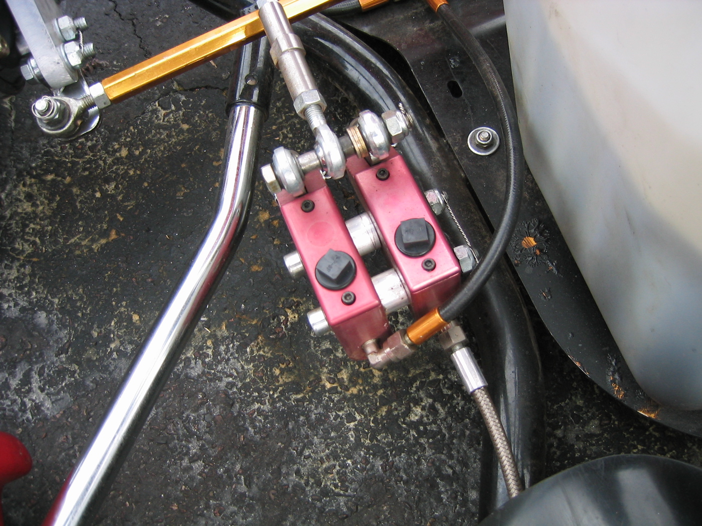

Benn Herr wrote:
Gene,
The MCP stuff will work great, it's what we use. Go with the billet ones, they have a smaller bore and it'll match your existing setup better. You may need to make a few of the bits to adapt the linkage and lines but there is nothing that's a show-stopper.
Benn, I like the brake bias set up you have in the picture! But it does look kind of "non-adjustable"! How did you do the heim joints on the lever arms, weld on? Would like a better picture of just that part... it is Sooo clean compared to most.
bill

PostPosted: Mon Oct 12, 2009 1:12 pm    Post subject: Reply with quote
Bill,
It's adjustable, just not quickly! Once you find the balance you need you hardly ever change it. The bosses are just welded onto a standard arm that has been cut down. Make sure the bosses are think enough to withstand the heat without distorting, Trim the arms to fit, clean all the cad plating off and have a good welder do his stuff. Oh, and don't try welding on the arms with out taking them off the masters! I don't have any real good pictures but these should help.
I made our bosses out of 5/8" solid steel and drilled and tapped them. The rod ends are 5/16". Use good quality ends - it's important! 5/16" is also about the minimum diameter you can use for the balance bar. Any smaller and it will bend when you use it.

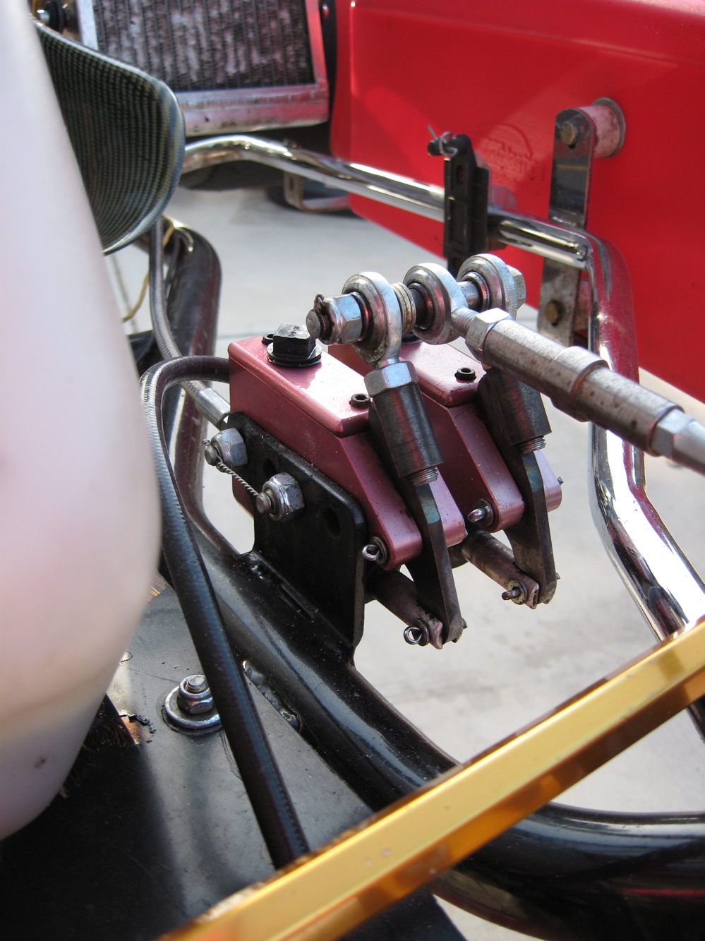

Benn Herr wrote:
Bill,
<snip> Pictures are just great, thank you for them.
Ben, I may just have to make up some parts..really hate the floppy linkage.
-bill

PostPosted: Tue Oct 13, 2009 3:37 pm    Post subject: Reply with quote
The thing that always scares me on those masters is those tiny pivot pins.
Mike G.
Benn Herr
Posts: 1579
PostPosted: Tue Oct 13, 2009 4:49 pm    Post subject: Reply with quote
Mike G.
Actually the pivots are not as small as they look. The cotter pin goes through a split roll pin that is pressed in to the body ears. When I took apart an old master cylinder (old, as in from the 80's) to rebuild it, the roll pin was only slightly worn.
That said, I am more comfortable with the machined billet ones I have versus the cast ones. But i've never seen one of those break either.
